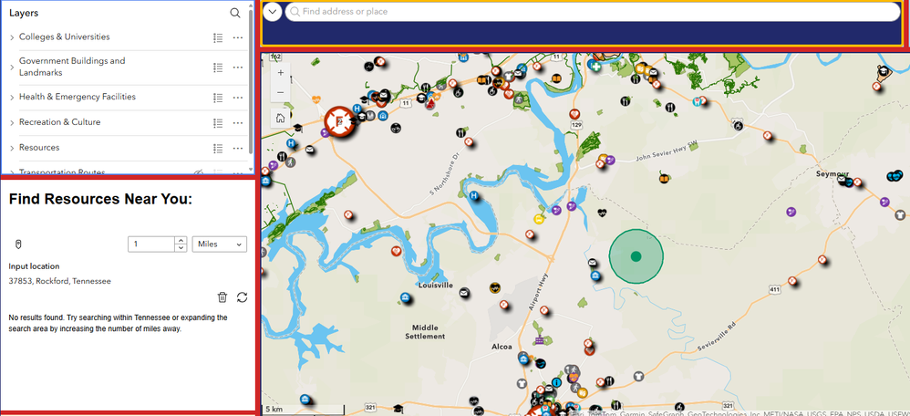

I created an experience in ArcGIS Online and am having trouble with the Near Me widget. For a while there were a few layers that had intermittent issues filtering out features that were outside of the search area, but now it is almost all of them. Eventually I realized that it was no longer filtering ANY layers that did not have at least one feature inside of the search area -- so as you can see in the screenshot, where I searched in a rural area containing none of my map features, none of them filtered out.
The results list is finally working, which is the main goal, but I just don't understand what I'm doing wrong and why these settings aren't changing anything. Any advice is appreciated! It is a resource locator tool essentially, and I am not married to any of the details (except the brand colors of course), so I am willing to try anything. Thank you in advance

Hi @KimberlyPettigrew
Have you looked at the layer visibility incase it a scale threshold set or any particular filtering
Do you have any grouped layers, try ungrouping to see that improves performance?
Are the output data source connected to the results list etc?
I hope this helps in some way.
