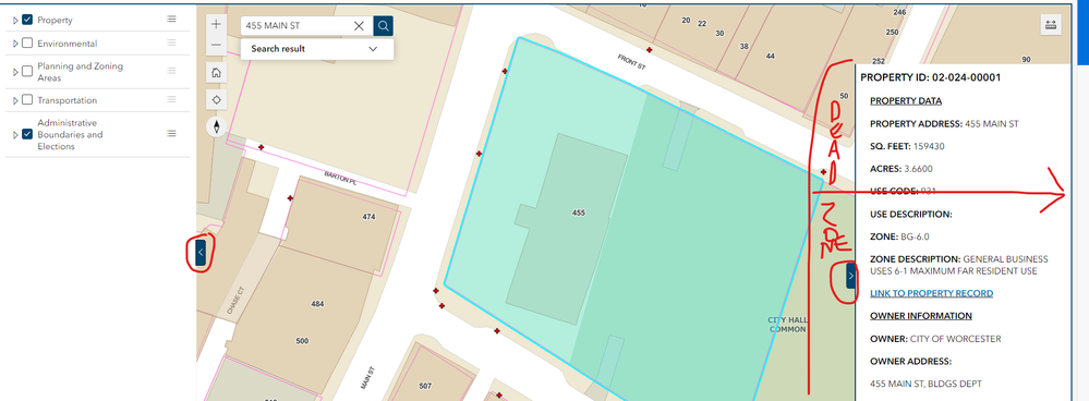

I am creating an Experience Builder app that includes a collapsible sidebar on the left side of the map that includes a layer list.
I have also configured a Feature Info widget so that it returns results from a Search widget associated with the map. I would like this Feature Info widget to be in its own collapsible sidebar on the right side of the map but when I implement this, there is a dead zone (where you cannot pan/zoom/click on the map) around this second sidebar and when the sidebar is minimized, the dead zone includes the entire extent of the (maximized) sidebar.
My question is: Is there a way you can you have two sidebars in an app without having this dead zone issue? If not, is there another approach to having a collapsible window of some kind that includes the Feature Info widget?
When two sidebars are added, there is a dead map zone around the 2nd one.When two sidebars are added, there is a dead map zone around the 2nd one.

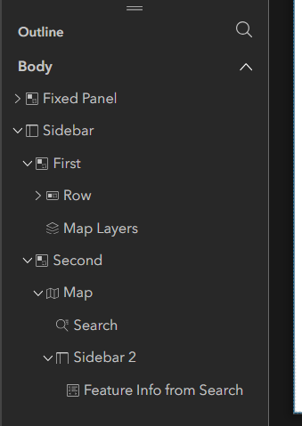

I made a bit of an error in that post where I said "First is the always open side. Second is the collapsable side." That is not actually true. The First and Second side actually change based on how the sidebar opens.
In your stacking order, Sidebar 2 is inside the Map. The Map should be inside Sidebar 2 which should be directly under the Second label.
This is how my double sidebar application looks.

Hi Jeffrey,
Thanks for that - it definitely helps me to understand why this is happening! However, I'm still struggling with the order the elements should be in. The second sidebar is actually nested within the first one already. Right now it is under Sidebar/Second/Map. Any advice on how they should be re-ordered? Should it be under "First" where the elements of the left sidebar are? I haven't mastered the trick to actually performing the re-order of the elements too. It seems a bit tricky. Thanks again.

Great, thanks so much for the info. I'll give this a try!
WorcesterGTSS
This solved the issue - thanks again for your help! It's not an easy task to rearrange those elements but I managed!
