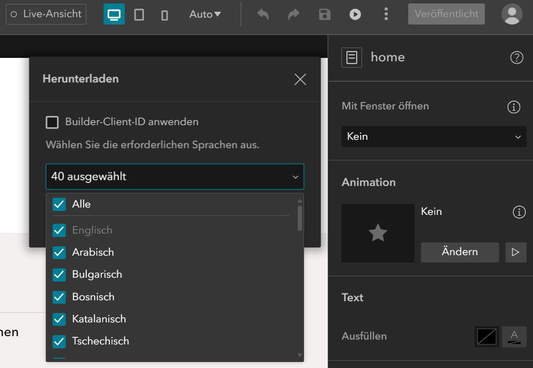

  • manually via ExB-Dev manually and selecting "all" for the languages AndreasEugster_0-1770804643047.png

Both resulting in an index.html with the populated downloadLocales array.
