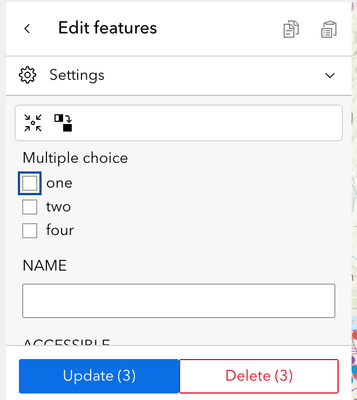

Hi,
I am trying to use the merge tool in Experience Builder's Edit Widget to combine polygon geometries. However, I'm unable to locate where the merge tool is located once I check the "Merge" box in the Editor Widget settings. The copy/paste tools are visible but the merge & split tools are unavailable even though I have them turned on (see screenshot below).
Has anyone else experienced this or know why they aren't appearing? I know these functionalities were added somewhat recently to EB so I'm not sure if it is a bug or something simple I'm overlooking. I haven't been able to find much documentation on the issue.
Additional Context: I have geometry editing enabled on the layer and I have batch editing enabled in the editor widget.
Thank you!

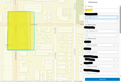

g_maps
Hi Craig,
Thank you for the reply, I double checked and that option is actually not available for me. Any ideas as to why? I own the layer I am working with and all editing is enabled except for deleting features.

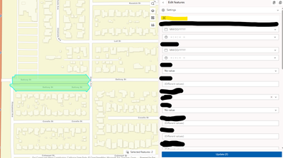

g_maps
@CraigGillgrass I did some more testing by creating a new polygon hfl, and interestingly enough, I was able to use the merge edit tool, but others in my organization weren't able to see the merge option until I enabled the ability to delete features on the hfl.
However, on my original layer, as the hfl owner, I can't use the merge tool at all. I think that because the layer was published a long time ago, I need to update the service definition or republish.
Also, would it be possible to allow users to merge with the editor tool while keeping delete privileges disabled? I want users to be able to merge polygons and protect historical data.
CraigGillgrass
@g_maps ah, this explains it.  The delete privilege is required for the Merge tool; since it's deleting one of the features.
The only way around this would be to use the Web Editor Instant App template which allows you to configure an app and remove the Delete tool, while keeping the Merge tool.
