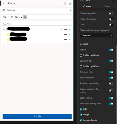

Hi,
I am trying to use the merge tool in Experience Builder's Edit Widget to combine polygon geometries. However, I'm unable to locate where the merge tool is located once I check the "Merge" box in the Editor Widget settings. The copy/paste tools are visible but the merge & split tools are unavailable even though I have them turned on (see screenshot below).
Has anyone else experienced this or know why they aren't appearing? I know these functionalities were added somewhat recently to EB so I'm not sure if it is a bug or something simple I'm overlooking. I haven't been able to find much documentation on the issue.
Additional Context: I have geometry editing enabled on the layer and I have batch editing enabled in the editor widget.
Thank you!

@g_maps the Merge tool will be available once you click the Edit button at the bottom of the panel. It will be in the toolbar to the right of the "Zoom to" button
