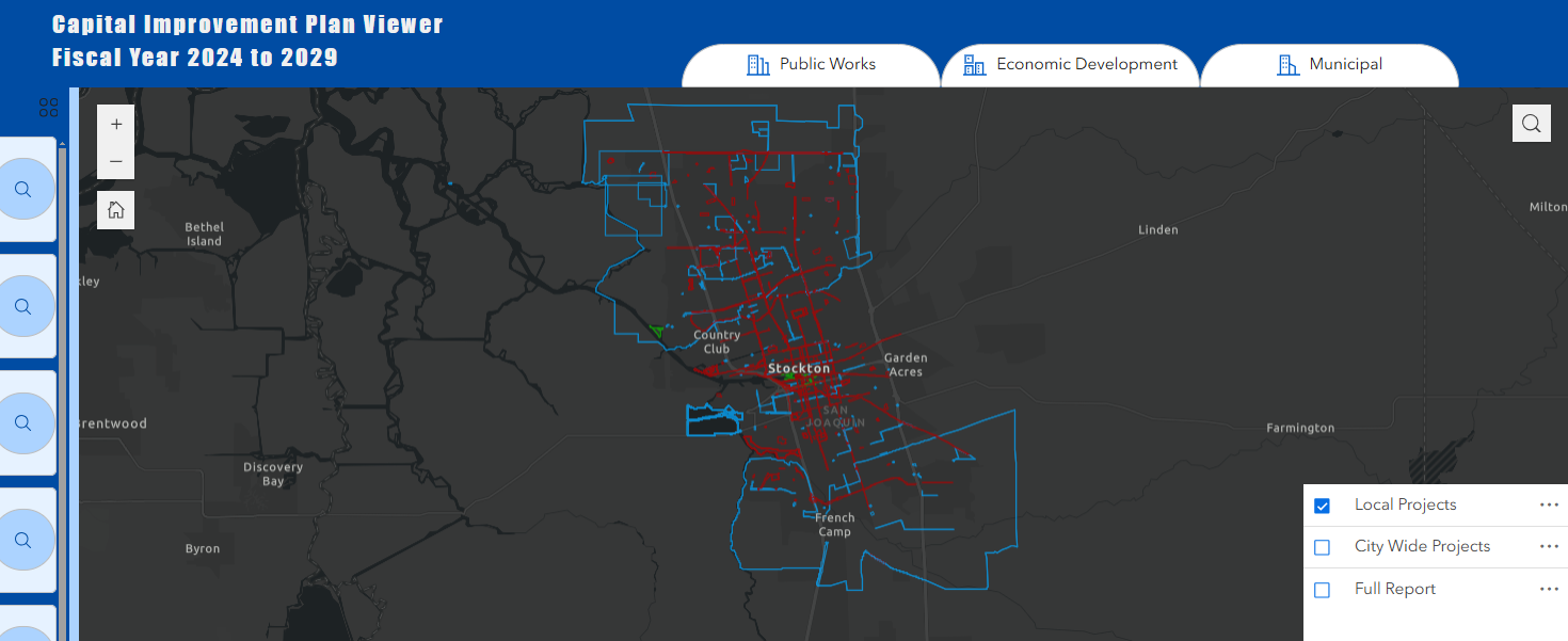

  Is there a way I can show in one layer, a specific value (there's 3 of them in one layer) by default?  I've used filters but it still shows all of them every time I navigate to a different page.  See sample below:
Under the Map Layers, Local Projects, the 3 values I have are:
Polygon Feature Class
1. Public Works - Red
2. Economic Development - Green
3. Municipal - Blue
For each page I want to navigate to, I want it to filter based on their respective values.  So if I want to go to Public Works page, I want it to show only the red polygons.  If I want to go to Economic Development page, I want it to only show green polygons, and same goes for Municipal.

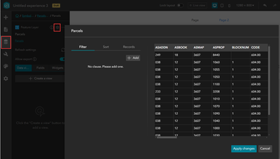

Add the same web map three times to the Experience Builder. Set filter conditions in the Data panel. Add a different web map on each page.
