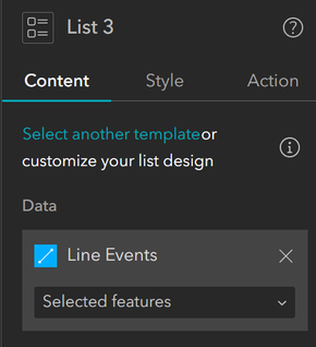

In the List properties, I set the content to the line layer of interest, selected features only:

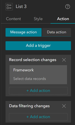

For the trigger, on selection changes I have the list display selected records:

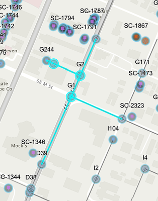

So when I select an area:

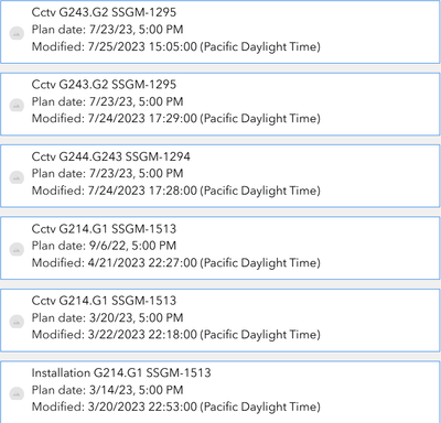

The list shows the records of interest:
