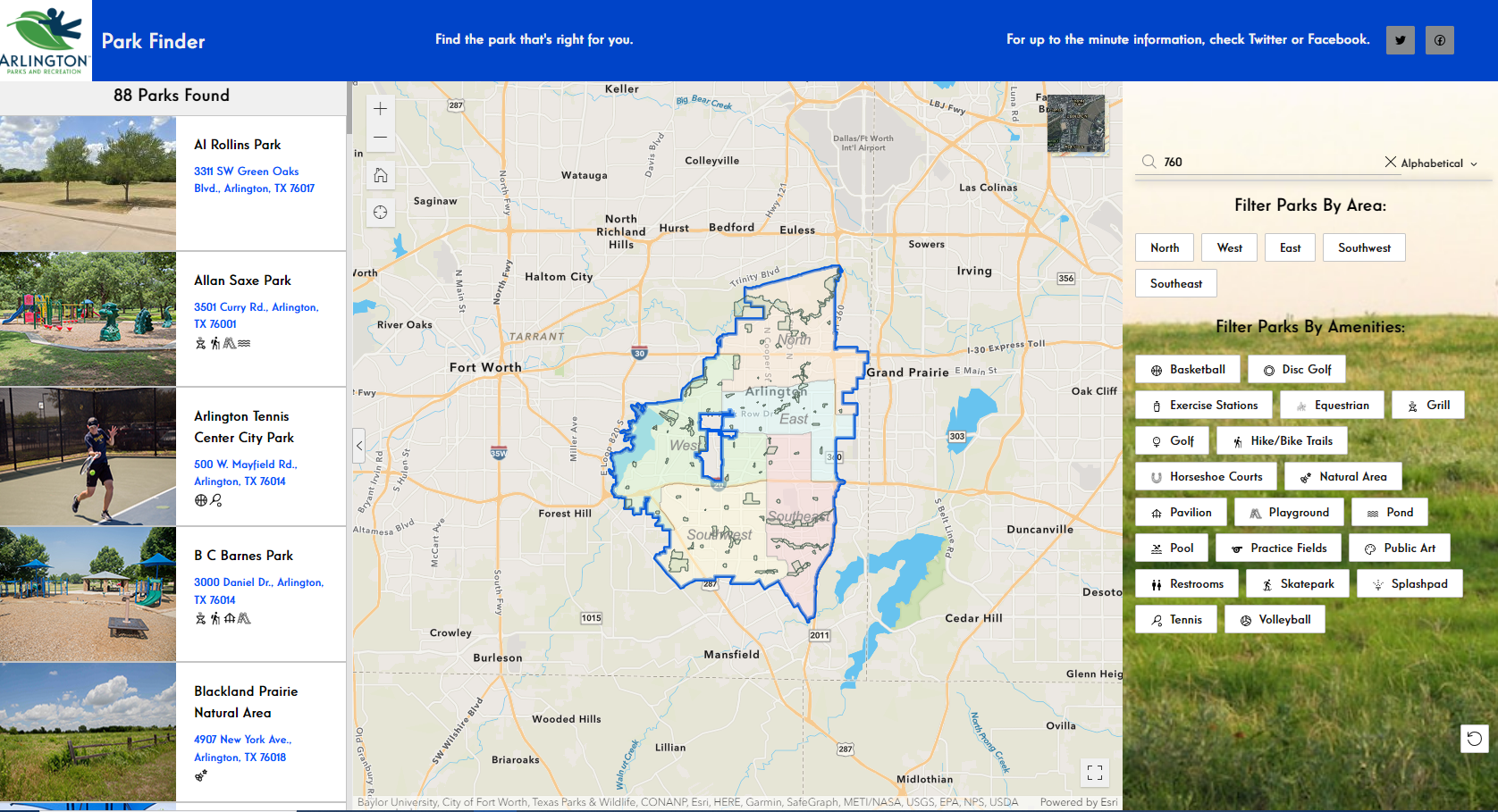

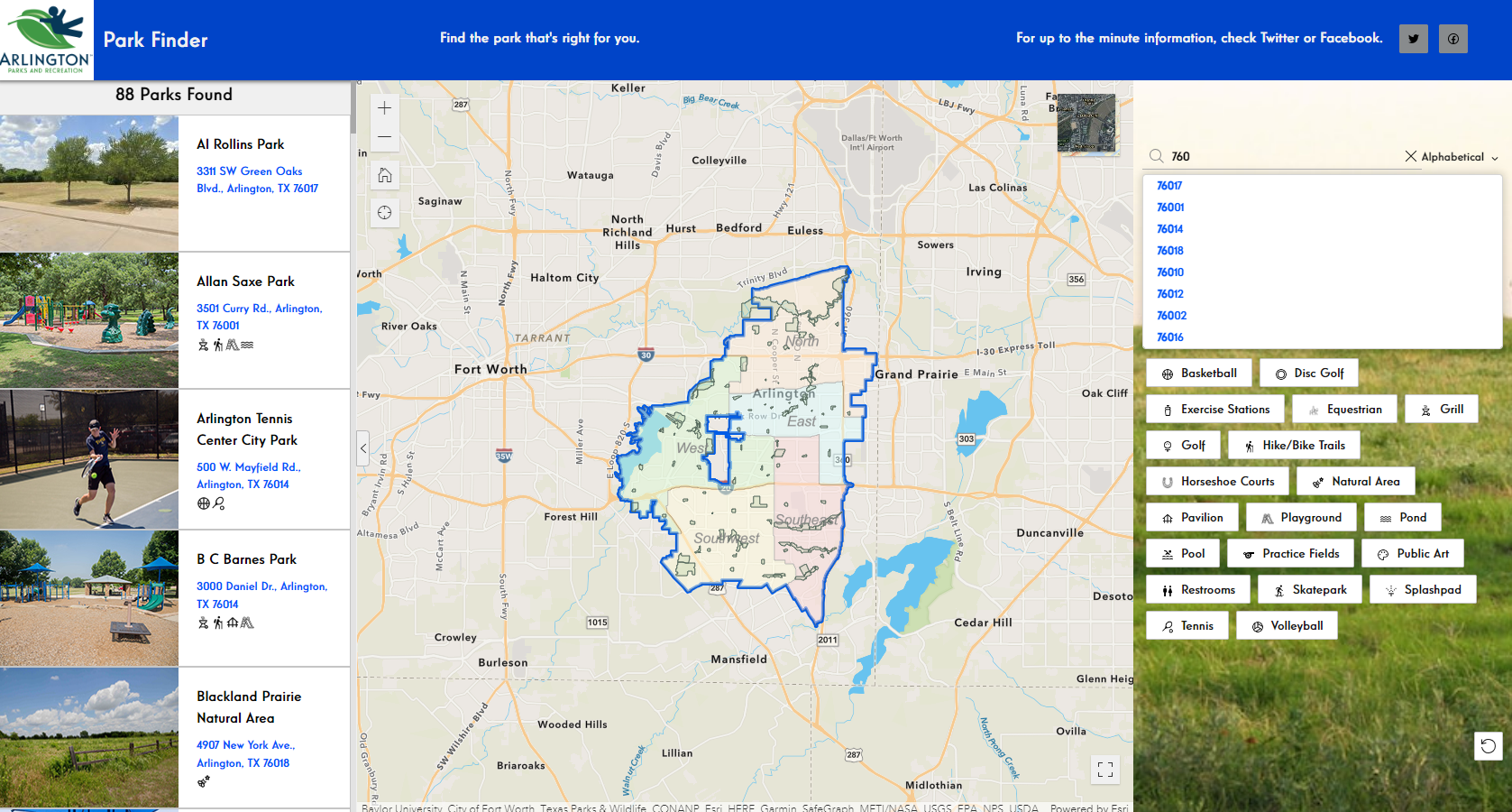

I have just upgraded from 1.11 to 1.12 version of developer edition and the search function of the List Widget is not giving suggestions in the 1.12 version.
Version 1.11 (Search bar from list widget on right side. Left side is a custom list widget.)
Version 1.12
The area where suggestions should appear greys, but no actual suggestions.

Hi @JeffreyThompson2 ,
After conducting an investigation, it has been determined that this issue is not related to regression. The issue stems from a filter applied to a geometry field in the original data source.
DISTINCT is not supported with geometry. However, when querying for suggestions, distinct values are being used.
To address this issue, we have planned an enhancement: when querying for suggestions, the returnGeometry parameter will be set to false.
Please refer to the rest API documentation at: https://developers.arcgis.com/rest/services-reference/enterprise/query-feature-service-layer-.htm
As a temporary solution for this release, a workaround would be to remove the filter from the original data source.

I would like to reiterate that  suggestions were working just fine in 1.11.
The filters from the filter widgets are all turned off. There is a filter on the data source in the webmap, but it cannot be removed as it is hiding information that should not be shown to the public. (We have parks which are not yet open to the public, so we don't want them shown to potential visitors yet.)
The primary purpose of upgrading was to try out the Near Me widget, but in testing, I found the interface to be too clunky for civilian use. The ideal version of Near Me for this application would just be a search bar in which the user could enter their address and it would filter or sort the list by proximity.
For now, we will keep using the 1.11 version.
