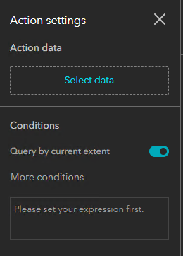

You would want to take Action on the Dataset.  Try clicking on Framework:
Then Filter Data Records
And then hit Select Data to select the data you use with the List and Map
EdDean
Thanks Dave!! This solved the issue.
