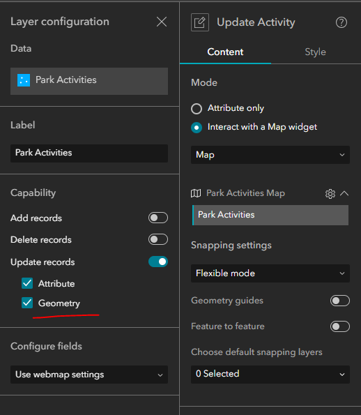

@StephenEJohnson Have you tried to turn off geometry updates in the Edit widget settings for the layer in your map? This should still allow you to edit attributes and attachments.
StephenEJohnson
That's it! Thank you!
