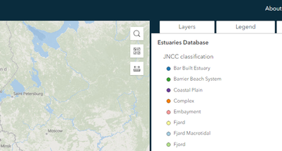

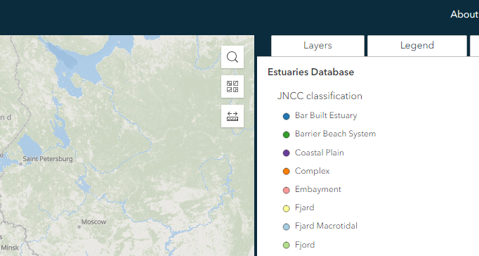

I have an issue with the legend widget when switching between desktop -> mobile layouts.  The desktop layout uses a grid with a main map pane, bookmark pane along the bottom and a fixed right-hand pane for legend, layers and queries.
If I change the layout to tablet or mobile view, the map now appears in an extra tab along with the bookmarks.  This is expected behaviour, however the linkage between map and legend is lost, so no legend is shown.
If the app is returned to desktop view the legend is re-united with the map
This behaviour can be triggered in the editor in live view or the published app.
Is there a way to keep the legend populated in all 3 layouts?
