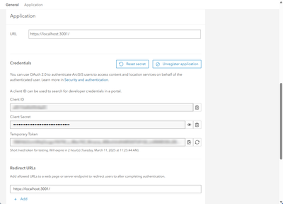

Step 7: Asks you to save the Redirect URI. This is not possible as you must put an URL for the application at the top. The instructions does not specify what to put in here.
It also asks to copy the APP ID in this section. There is nothing here named APP ID. I am assuming they mean Client ID, but it is just a guess.

For Step 7, use "https://localhost:3001/"

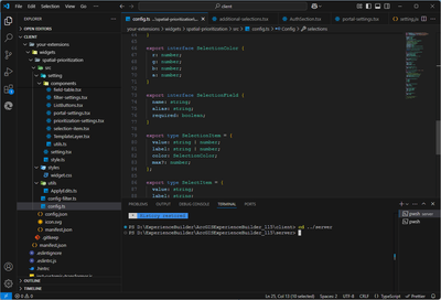

For Step 8, navigate to the directory where you have unzipped the Experience Builder files from the downloaded zip file. On my machine, it's located at D:\ExperienceBuilder\ArcGISExperienceBuilder_115, so I navigated to the directory D:\ExperienceBuilder\ArcGISExperienceBuilder_115\server to run "npm ci"
If you're using Visual Studio Code and opened the client folder as a project as explained here, you can also open a new terminal (Terminal|New Terminal). That will automatically put you in the client directory, , but you can easily change to the server directory with the command "cd ../server". You can run "npm ci" in that terminal
You can use this terminal window to start the server in step 9. You can open another terminal window and run "npm ci" and start the service for the client directory. You can see both of these terminals in the screen shot above, which is how I have this set up for my widget development, instead of using two external command windows.
