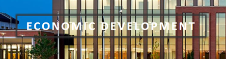

JennaWalz2
Hello,
Thanks for the response! I am using Experience Builder of ArcGIS Online and I am using a default theme. I am trying to change the color of the text background.
When I view the published site on google chrome or on my phone I get this.
Thanks,
Jenna
Wei_Ying
Thanks Jenna. I can reproduce the problem occasionally. It should be a bug with change "Save" in text widget. We will try to figure out why.
Something you can try:
1. After change the color, save and refresh the Experience Builder. See if the change stays?
2. If not, do it again, save and publish. View the published app, see if changes are taken
Please let me know if it works for you.
Thanks,
Wei
JennaWalz2
The change is correct in Experience Builder but incorrect on the published site. It works perfect with the custom colors but not with the Organization colors.
Thanks,
Jenna
