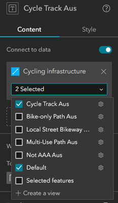

The first SUM being the total length of Cycle Track, the second SUM being the total length of all cycling infrastructure. The widget is connected to two Views: the default view and one with the filter: Cycling Infrastructure is Cycle Track.
The issue with this expression is that when I zoom into an area that has no cycling infrastructure, the widget displays: CYCLE TRACK 0 Km Total Length, Expression 1% of Total Network

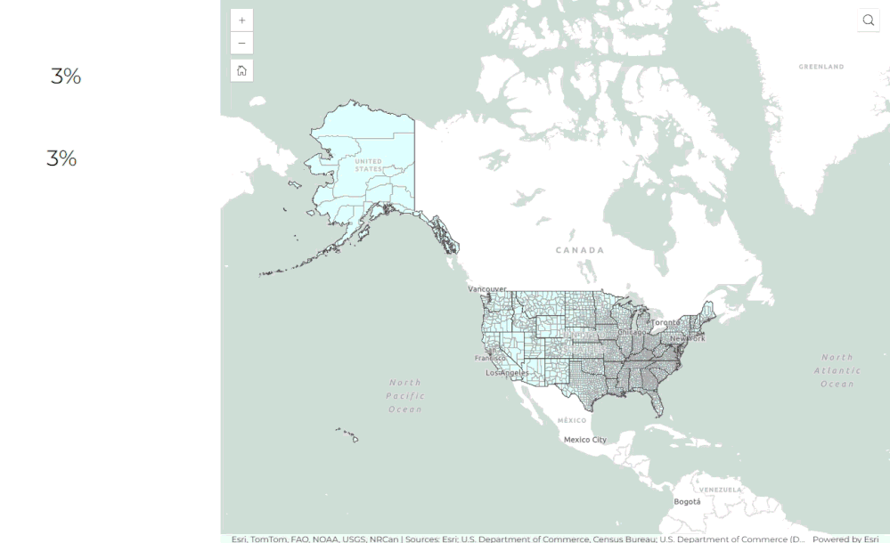

@Tim_C, it's just defaulting to showing the name of your expression, which you can rename. For example, here's a quick (non-sensical) example I put together with expressions showing how much of the population in view is part of Michigan. The top dynamic text has a generic expression name, and the bottom I've named "0%":

Haha, that is genius in its simplicity! I'm actually trying to learn how to code, so I will try Venkat's suggestion first, and if I can't get that to work, resort to naming my expression 0.
