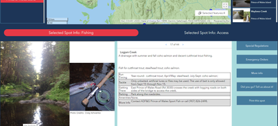

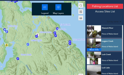

In other words (and pictures), I want users to be able to click the 'More Info' button from their selected site in the List widget...
... and jump to the more info view below the map:

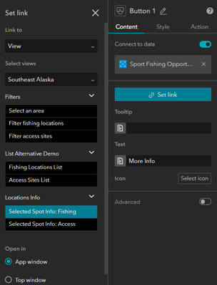

Here are the current settings that aren't accomplishing what I'm needing:
I have a sneaking suspicion that I'd have to turn the more info section into a separate page, but that really isn't the preferred route of action. It seems silly because opening a new page is a separate setting... so if the settings to link to a view and to a page work the same, why offer them separately as configurable options? Many thanks for any help!
