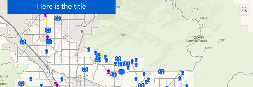

Hello,
Is it possible to move the search widget to a different location in the Launchpad theme in Experience Builder? I would like to move it to a widget controller. Capture.PNG

Experience Builder has two search functions. One of them comes embedded in the Map widget as one of the map tools. These map tools offer no customization options and extremely limited placement choices. There is also the much more powerful and customizable Search Widget that you can place however you want. To switch over to the Search Widget:
  1. Unlock your layout.
  2. In the Map Widget Settings, turn off Search.
  3. Drop in and configure a Search Widget.
  4. Drop in a Widget Controller and drag the Search Widget inside.

ScottShenberger
Thank you.
