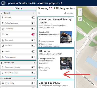

Users interact with the Experience using the Filters to limit the records shown in the List.  The problem I'm having is that the individual List elements seem to have a fixed height but the contents are variable depending on the feature displayed.  In the image below you can see the problem that there is a big bit of empty space in the KB House item  because that feature has less information to display:

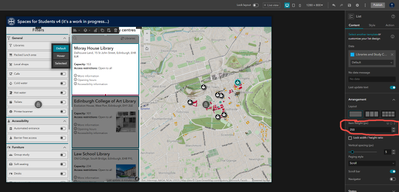

The only setting I can see in Experience Builder that controls the height of the individual List items requires a value in pixels, meaning that all list items are displayed at the same height, regardless of their contents:
