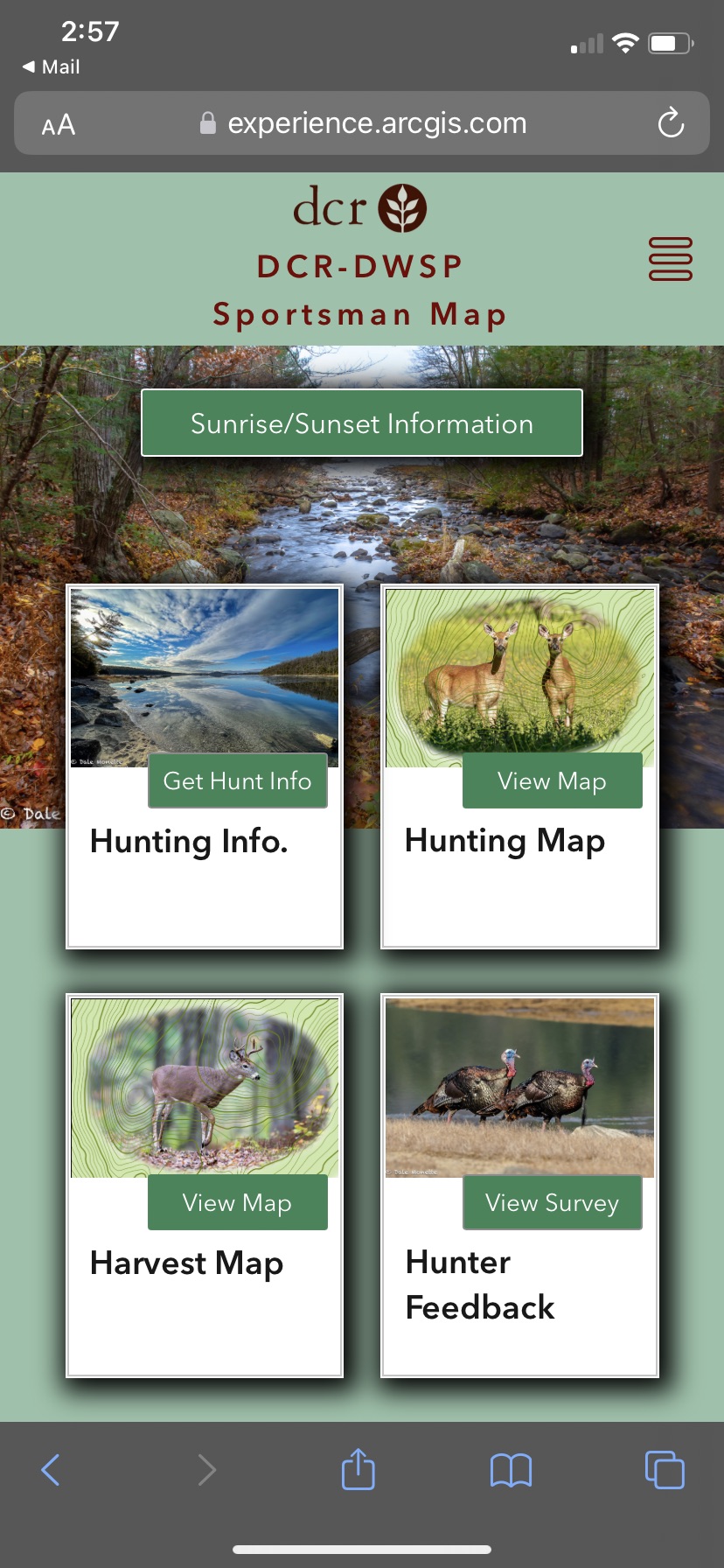

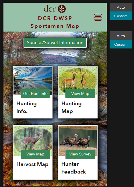

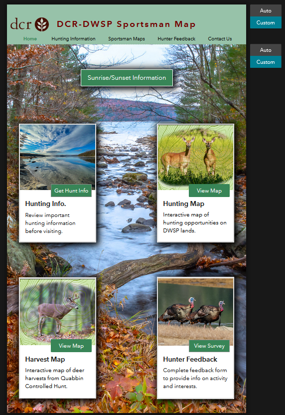

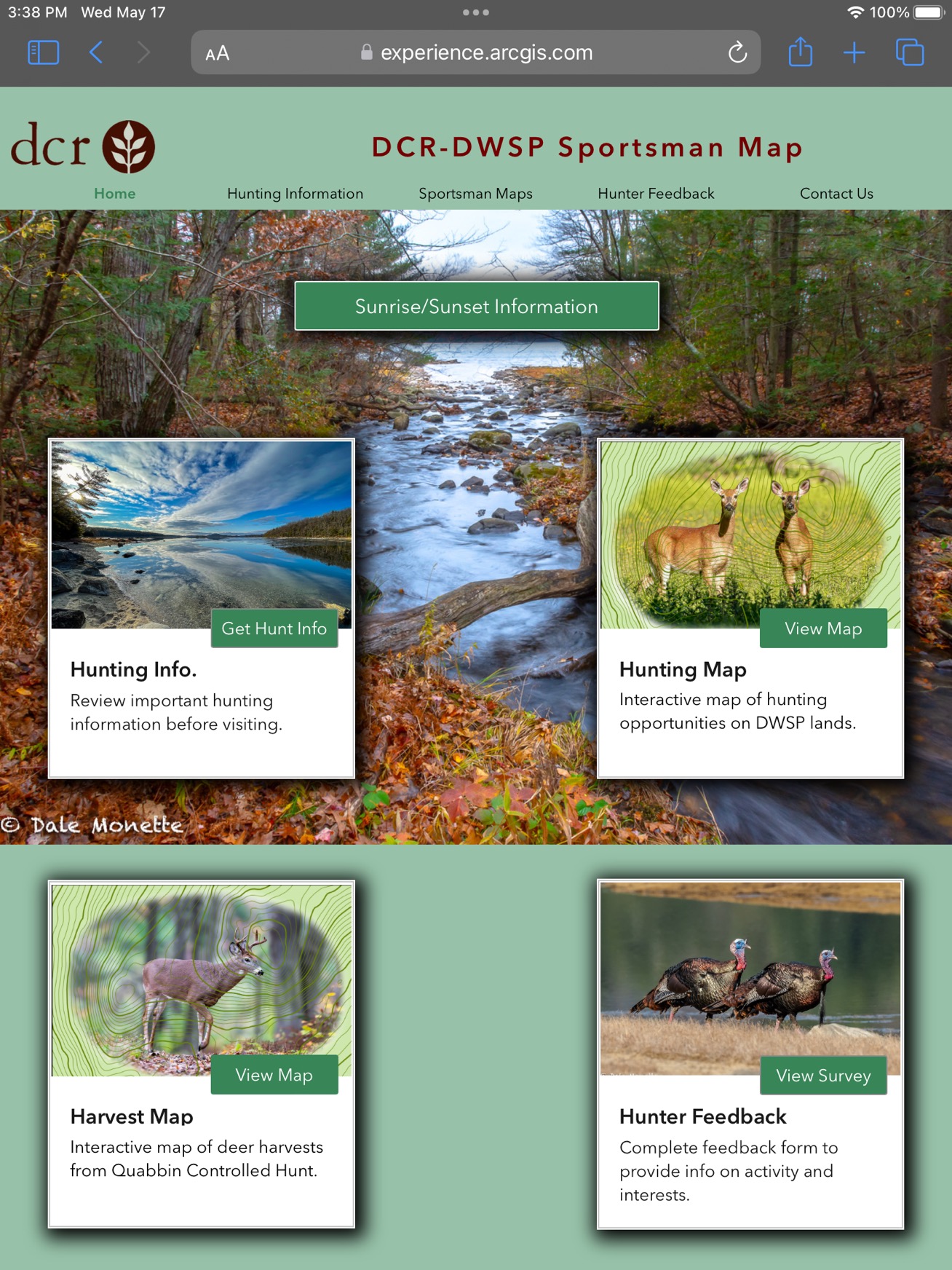

I am designing the tablet and mobile layouts for my Experience. In all of my designs, I am using the same background image for my apps home page. I've got the image position set to "fill" and this is honored within the Experience designer, however when I view the published version on my tablet and mobile device, this is no longer honored. On my iPhone, I have tested this in both Safari and Chrome with the same results.
Please see both sets of examples below.
Is this expected behavior? Any ideas to make this work as shown in the designer?

Mobile preview in designer:
Published mobile version on iPhone:
Tablet preview in designer:
Published tablet version on iPad:

@erica_poisson Erica, unfortunately it looks like the same known limitation mentioned here as well as documented in our doc site - https://community.esri.com/t5/arcgis-experience-builder-questions/image-widget-tablet-and-mobile-quo...
Avoid using iOS or MacOS tablets, you will see the expected behavior.

The iOS limit of "Fill" has been resolved with the latest AGOL October release, so cases with iPhones or iPads, or macOS browsers should work fine now. Let me know if you encounter any other issues. Thanks!
