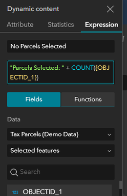

I thought maybe I could check "View for empty selection" and then give it  filter like OBJECTID = -1, but that doesn't work. And I don't see anyway to get an Arcade expression to work in ExB.
AndyWells
Well, I just realized if I use the "Expression" tab under Dynamic Content for the text widget, instead of "Statistics", then I can give the expression a name, something like "No current selection" and it will display that text when there is no selection.

Could you post your syntax? I tried the Expression tab and didn't get it to work. What happens with a blank name? Maybe you could even try grabbing an invisible unicode character?
GIS Developer
City of Arlington, Texas
AndyWells
I created an expression to display the words "Parcels Selected: " and then the number currently selected. Above it, where it normally says "Expression 1", I changed that to "No Parcels Selected"
