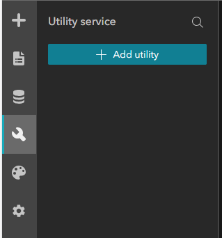

Most of the docs I read suggested going to the gear icon in the editor and add utility:
But I know if you don't have a url for the GP Tool this kind of goes nowhere 😕

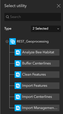

Yes - you are correct and this helped me figure it out.  When I added my first set of 6 custom tools. I specified the shorter URL of the service which seemed smart at the time because Web Experience Builder recognized that there were multiple tasks and added them all to my list of tools.  I ended up with this:
However when I added a new task to the service (Task7) I couldn't get it to refresh the list and let me configure Task7.  I think what I should have done is from the beginning, add each of the 6 original tasks separately their full task URLs - in other words never use the shorter service URL if you might add tasks to the service.  Then later on I hopefully can add Task7 with its full task URL.  I'll try to test this in the next couple of days to verify.
