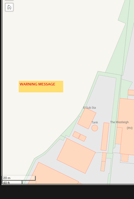

dataInExtent = true OR inBuilder = true:
dataInExtent = false
