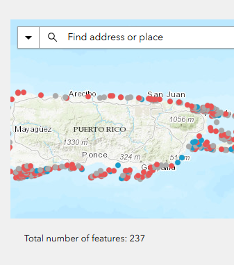

 This is what it looks like in while editing the Text widget. "Feature Count" is the name of the Arcade script.
And this is what the final result is
