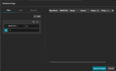

When you say map widget settings, are you talking about the settings on the layer in the map, shown here?

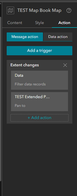

Or do you mean within the map data actions here?

The 1st image is correct and should work.

Hmm it seems like whenever I set the filter on the layer specifically in that data tab, it does cease to show up on the map. However, the data action does not override it, so it just does nothing when selected in the list. This did seem promising though, it just seems like the layer stays filtered by the object id = -1, and ignores the data action filter.
