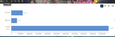

Howdy all,
I am working on an experience builder that utilizes a bar chart with value labels:Annotation 2024-05-20 112735.png
I would like to format the value labels/change how they round. Is there any way to make this label say 3.9M as opposed to 4M? Is there a way to display the value without any rounding at all?
Thanks in advance.

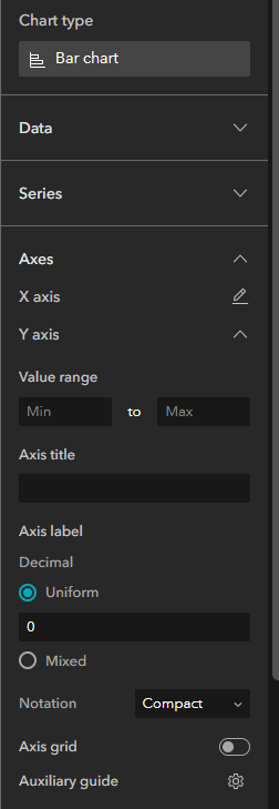

I found it! It is in the Y Axis panel under the notation drop down. If you set it to compact, you will get rounded numbers with an abbreviation added to the end. Standard will of course be normal notation.

I don't think that's directly possible in Experience Builder. However, I did create a quick bar chart and it's not rounding off values on my end.

Wes_S
Thanks, Ed. I did not find anything either. Maybe it is implemented only in the 100% bar chart.
Wes_S
