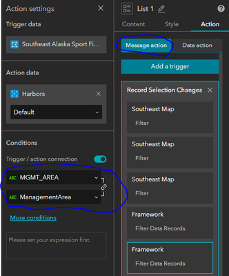

I think you should be able to simply set up a message action on the EXPEDITION layer that's using a ExB list to filter your framework based on whatever foreign & key field is common across the tables (see pictured for an example of one of my list trigger configurations). Are you finding that this isn't returning expected results? It sounds like filters would not be totally effective, as they don't operate via common foreign & key field between layers like lists do.

Your suggestion should work and it actually works to select  an expedition, trigger a message and get the respective specimens selected. But my situation has a second step that should show the localities of the selected specimens and that message doesn't work. I mean that it doesn't work when the specimen selection is achieved via a message. If I unselect/select the specimens manually, the localities are filtered correctly.
