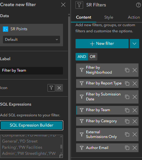

I have several filters on a single data source in one filter widget. Each filter operates on a different field, and most of them follow the pattern "[Field] is any of [selection]" from the Multiple source type, with "Ask for values" selected and "List values based on" = "All unique values of this field".
Screenshot 2026-07-08 120539.pngScreenshot 2026-07-08 120521.pngMost of the filters include some default values selected, and have "Apply this filter automatically" selected.

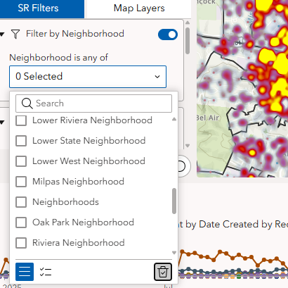

When the Experience is opened, the preconfigured filter application and value selections work as intended. When I open the dropdown for one of the filters, the "Show all" and "Show selection" buttons do what they should.

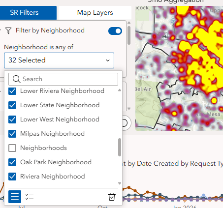

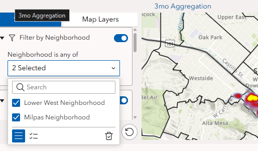

However, if I "Clear selection" for one of the filters, and then select only a couple of options, all of the other options disappear. Whether I have "Show all" or "Show selection" selected, only the selected options are available.
