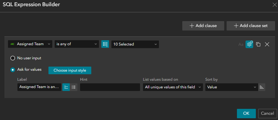

I have several filters on a single data source in one filter widget. Each filter operates on a different field, and most of them follow the pattern "[Field] is any of [selection]" from the Multiple source type, with "Ask for values" selected and "List values based on" = "All unique values of this field".

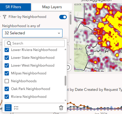

When the Experience is opened, the preconfigured filter application and value selections work as intended. When I open the dropdown for one of the filters, the "Show all" and "Show selection" buttons do what they should.

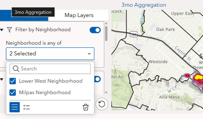

However, if I "Clear selection" for one of the filters, and then select only a couple of options, all of the other options disappear. Whether I have "Show all" or "Show selection" selected, only the selected options are available.

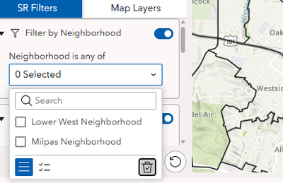

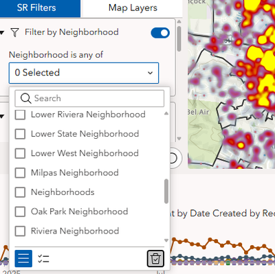

If I then "Clear selection", it deselects the options but the rest of the values do not reappear.
The only ways to get the full list of values back are to either use the "Turn off all filters" button or "Reset all filters" button (which returns them to their default state with multiple selections made for each filter).

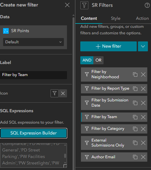

Group filters, data views (yes, different thing than a feature layer view): Google these (no shade, but you will get more out of the documentation than I can regurgitate to you). When you add a widget to the canvas, there's also an information icon in the upper right of the widget configuration panel. Click that and it'll take you to the documentation.
Re: multiple instances of a data source, my suggestion is to:
  1. Add another instance of your data (e.g., the web map if that's how you brought in your data).
  2. Re-name it (inside Experience Builder) so you can keep track of which instance holds the data you actually see in the map.
  3. Then, in your SR Points layer in this second data instance, make a data view called "Neighborhood."
  4. Go back to your filter and instead of basing the filter on the layer used in the map, create a group filter where the primary layer is this second instance of SR Points, specifically the "Neighborhood" data view.
  5. Then, add your map layer instance as a secondary layer in the group filter.
There's no need for triggers/actions for this, having the map layer instance in the group filter means it'll filter when the filter is applied. Repeat at step 3 for report type, submission date, etc. The reason this works is because the filter values are coming from data views that aren't being affected by anything else.
The downside is that there's no way to convert a single-layer-based filter to a group filter, so you'd have to redo the filters. Group filters also don't currently have the ability to do multi-clause filters, if you have any of those.
