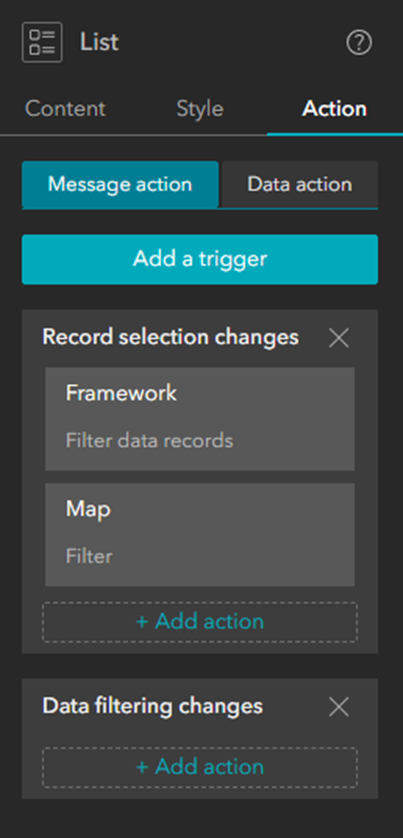

Here are screenshots of my Action items for the List widget:

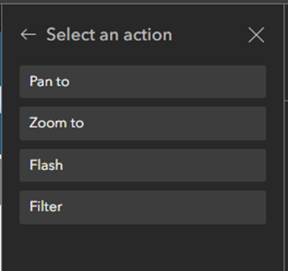

The "Data filtering changes" action only allows you to choose Map and either Pan to or Zoom to.
It would be nice if there were an option to filter, as there is one when the action item is Record Selection changes.

You shouldn't have to do any of that.  I'm working on a list widget right now in my Online ExB and I don't have to do any of that.  The only Message action I have set up is to 'Zoom to' when the 'Record Selection Changes'.
For the List 'Data' I am working with Default, not 'Selected Features' nor am I using a view.
But I also do not have any other inter-actions.
