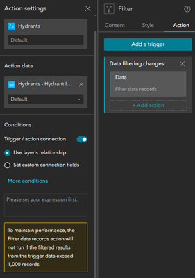

ShengdiZhang
Hi @AKRRMapGuy ,
In the latest Feb 2026 AGOL release, we support selecting and filtering data records using the "Data filtering changes" trigger. This enhancement allows related layers to be filtered automatically when a filter is applied to the parent layer.
Please note that there is currently a limitation for performance considerations: the action will not run if the filtered results from the trigger data exceed 1,000 records.
Let me know if you have any questions or need further clarification.
Thanks,
Shengdi
AKRRMapGuy
Amazing! This sounds exactly like what I need. One point of clarification, when you say filtered results, do you mean filtered out or remaining IE. 1000 hidden or 1000 displayed? Personally, if it runs a little slower, the option to go beyond that really wouldn't hurt my feelings, depending on the definition of performance.
Hopefully this makes it into Enterprise 11.1!
ShengdiZhang
When I say “filtered results”, I mean the remaining results after the filters are applied, not the records that are filtered out. So the limit refers to 1000 records displayed, not hidden.
This enhancement is currently implemented using a workaround. ExB sends multiple requests to filter the related table. During our testing, we observed that the app could crash when the number of returned records was very large. To maintain stability, we introduced the 1000-record limit.
If this enhancement can be implemented on the server side in the future, we should be able to improve the feature and remove this limitation.
Thanks,
Shengdi
