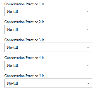

On the summary page, users can see the attribute table of the hosted feature layer. I'm building different filters so the user can summarize fields in the ExB or export the filtered table to CSV for further analysis. They need the capability of filtering by the different practices across all 5 of the practice fields. This can be done in the Filter widget by creating a "Clause Set" and asking for user input, which allows the user to select a value from the list. However, the user has to select the practice 5 times to search all 5 practice fields for one type of practice. I was wondering if there is a way to select the practice once but filter all 5 fields?
Here's the filter that works (but is unneccessarily duplicative):

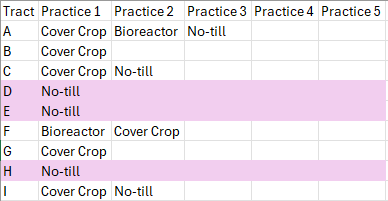

I've tried creating a Group Filter but even though I've selected all 5 fields in the "All fields" section, the "Main field" is the only one that's being filtered. Below is an example of what this looks like. I've selected "No-till" from the list, but the only records showing in the filtered list are the ones that have "No-till" in the first practice field (purple lines), not in 2 or 3.
