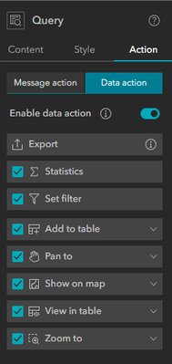

Over the past couple updates, ESRI has been adding the exact features you are describing. In the current Online version, it is now possible to send any layer to a Table Widget and the Table Widget as well as several others has the Set Filter Data Action which allows for the user to create their own arbitrary filters.

AbiDhakal
@JeffreyThompson2- It does not look like it is available in 11.2 either. I do not see the Set Filter and Statistics in ArcGIS Enterprise. I believe this must be brought to the attention of @Jianxia

AbiDhakal
It is not available on the List Widget either.
