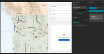

I have a very simple experience builder I'm playing with. It has a map with the Inaturalist data on it, and a list widget referencing the Inaturalist observation data. I can't seem to get the List widget to filter by the extent of the map. And when I try to modify the data to sort by the "Observation Date" field, it seems to crash the Filter widget. Is there another way to do this that I'm not aware of?

Hi LRoberts_RDM,
You could add a trigger to the Map widget.
Extent changes -> Framework -> Filter data records.
Thanks,
Ke
