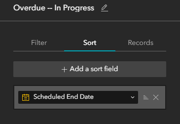

You can use Data Views to specify the Sort you would like to use in Experience Builder itself!
Create Data Views in ArcGIS Experience Builder
You can access the Data Views menus from the "Data Source" tabs on the lefthand-pane, or you can create new Data Views on the fly in the Chart/Table/List widgets:
D_Atkins

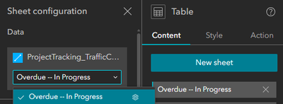

CianMcGuire
Ah great! I didn't see the extra options in Sheet Config. If you select 'Customize' after creating a new sheet it will prevent the auto sort on loading. Thanks D!
