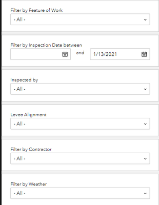

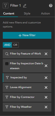

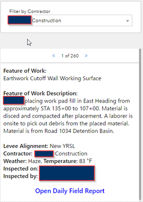

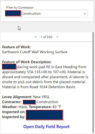

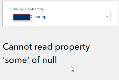

I am using ExB Dev 1.2. I have a feature info widget and some filters. The widget interaction works fine as long as the filter result returns a record. If the filter result returns zero record, the Feature Info widget content would change to "cannot read property some of null' and the only way to get rid of it is to refresh the web application.

@AzinSharaf  I was able to reproduce your issue. I noticed if the filter doesn't return any results the Feature Info will display no data, which is correct. However, once I  modified the filter the Feature Info did not update unless I toggled off and on the filter to run the filter again. The expected behavior is the Feature Info should update with the new results. Thanks for letting us know about this. We will get this fixed soon.

I have 6 filters (in 1 Filter widget) with AND combination. Let me know if you need more information.
