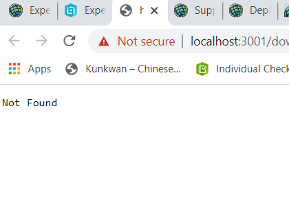

I had created an Experience in ArcGIS Experience Builder Developer Edition. I had follow the documentation from here https://developers.arcgis.com/experience-builder/guide/deployment-topics/  to download the Experience so I can share it in my ArcGIS Portal Organization.
But, I had encountered from the very beginning where I could not download and it is simply error which is
"Not Found"
May I know where I had gone wrong?
Thank you in advance.

@PutriKhalilahKamaluddin - could you please provide which Dev edition version are you using? It should have been fixed since v1.1.

I was using ArcGIS Experience Builder version 1.4

having the same issue (with v1.4) -- has this been resolved?

@asummerville @PutriKhalilahKamaluddin - In the dev1.4 version, if you have a special symbol or certain characters from other locales (e.g. JP, KO) inside the app title, there might be a problem with downloading the app. Could you please double-check and try a plain text title without any potential special symbols and see if it works?
FYI, the issue I mentioned above has been fixed in dev 1.5.
