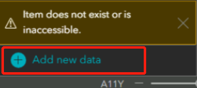

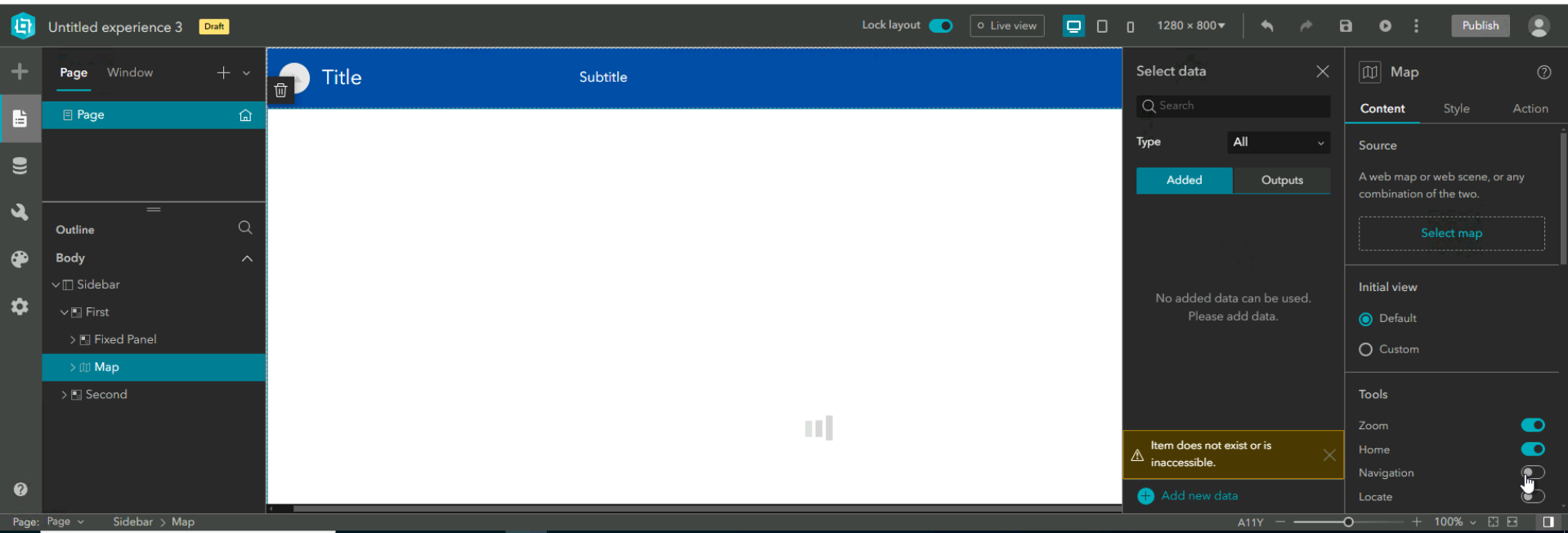

Error: "Item does not exist or is inaccessible"
Surely the item exists, what permissions can this be missing? Maps are shared publicly.
We are not able to add any maps into the builder, unsure what is triggering this and if anyone can guide us with the solution/workaround?

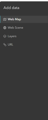

I presume that you already tried clicking on 'add data' and either browsing for a the map in your AGOL/Enterprise account (possibly under your group or organization?)

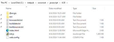

Can you kindly confirm if the process of hosting JSAPI in our offline env is same as mentioned in the doc below:
https://support.esri.com/en-us/knowledge-base/install-the-javascript-api-for-use-with-arcgis-for-ser...
This doc is old, but seems like we do not have any updated one to cross-validate?

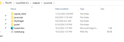

Our root IIS folder directory looks like this, is it correct?

I'm not sure what in your IIS setup you are asking about.
My understanding is custom widgets can be hosted on any server through IIS (it sdoesn't have to be on exactly the same server as enterprise)
The reason is because inside of portal you can configure a Widget for EXB with a custom URL path to load, and it should pick it up when you load the editing dashboard. (That configuration i through a web browser, but only admins I think have rights to create those.)

The side bar for add data has some options:
They can help you select a Web Map, a Web scene, Layers, or use a url directly from another GIS service
and on the right side are categories of permissions type (just like the sharing permissions I mentioned)

@Yogesh_Chavan Can you add new data through add new data button? Is all data unavailable or only the current data unavailable?
Yogesh_Chavan
@BolanChen, thank you for looking.
All the data is available, just that we cannot add it in the experience builder.
BolanChen
I mean can you add other new data via Add new data button? Can they be used normally in map?

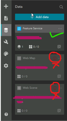

Yogesh_Chavan
No @BolanChen , it trigger the same issue when using the add new option in the map widget or through the add data option in the experience builder, works for only Feature services.
BolanChen
It seems that the problem is that the data cannot be used. You can check the network to confirm whether there is a problem with your map service or you do not have permission to access the data.
