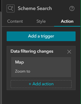

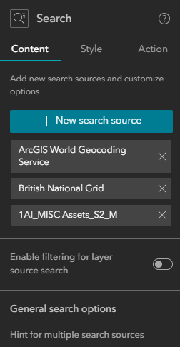

I have recently started using experience builder to build a really basic experience. Within this experience I am trying to allow my users to search for a Grid reference / address / asset name (all in one search0 and then when selecting the result it will zoom to this area.
I have set the search up of these parametres and added the trigger for zoom to within map (see below) but when I select the results from the search it wont zoom to. It is worth mentioning that the basemap is a custom high resolution basemap, I dont know if this plays a roll at all.
I have tried everything I can think of to fix this but have no clue why it wont work. I have another search function in the same map based on other features and it works perfectly on there.

@EdHixson - Could you try using "Record Selection Changes" rather than "Data Filtering Changes"
Also if you want to use a Custom Scale on your customer basemap then set that within the Zoom Scale Option.

As ad add on in the 3 above, the zoom function works on MISC_Assets but now BNG or World Geocoding. I assume this is related to the basemap.
Any suggestions would be greatly appreciated
