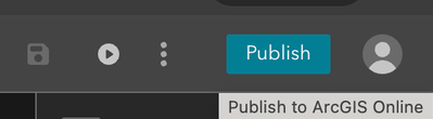

Here are some recommended ways to share the app. Please note that you need to publish the app first.
  • Copy the item URL from the dropdown menu in builder, or click "View published item" and copy the URL in the browser's address.

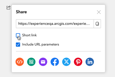

  • Add a Share widget and copy the links from it
