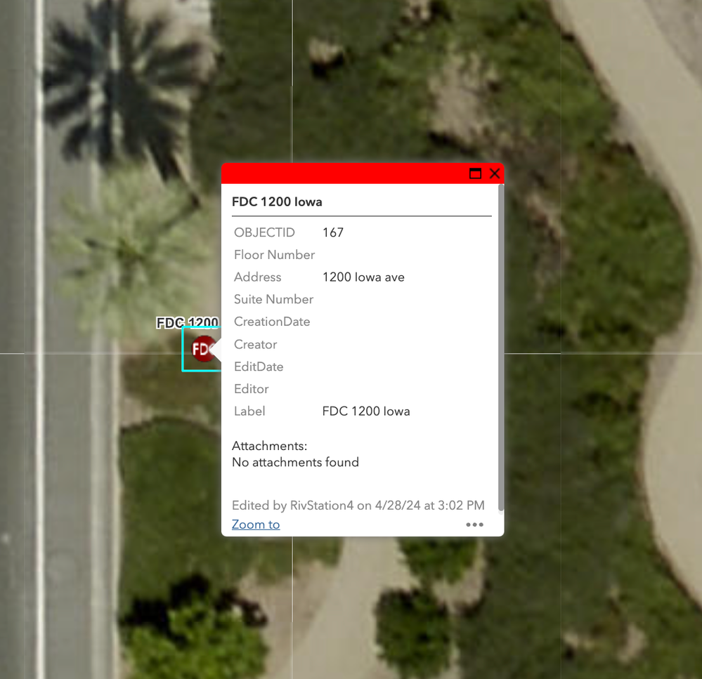

In WAB the ellipses would appear on the pop up window with navigation for directions to the location.  How do you build or configure this in EXB?  See screenshots.Screenshot 2024-05-16 at 6.05.33 AM.pngScreenshot 2024-05-16 at 6.05.33 AM.pngScreenshot 2024-05-16 at 6.11.25 AM.pngScreenshot 2024-05-16 at 6.11.25 AM.png
