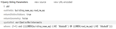

I have come across a similar issue. It appears the search widget searches well if you copy and paste a whole address, but... if you type in an address it slows right down. In developer tools it looks like it does a new search for each string you enter using "%LIKE%" to look for that text, and it starts a new query for each character you add. So it's not using begins/starts with. So it's slow to load results unless you copy and paste a full string. Can this be improved through configuration? Or is it strictly the Search widget in-built settings?

Which version of Experience Builder are you using? For ArcGIS Online, using "begin with" to query suggestions was introduced in November 2023. For ArcGIS Enterprise, it's available from version 11.3 onward.
Currently, it is by design that new requests are sent to query suggestions whenever the search input changes. We're considering modifying this behavior by not sending requests if the user has disabled search suggestions. We'd like to know if this potential change would address your concerns.

Thanks for your reply. We are using ArcGIS Enterprise 11.1.
Good question, I think the option to disable search suggestions would be useful, but with the introduction of begins with in later versions I think we wouldn't need it ourselves. Thank you.
