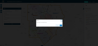

For some reason, the Print widget in my Experience Builder app is asking users to sign in, even though the dashboard is public. Here's the link to the dashboard: https://experience.arcgis.com/experience/6d9dc812a8d6480494c9e652e94b67ef
Is there a setting I need to enable to prevent this from happening?

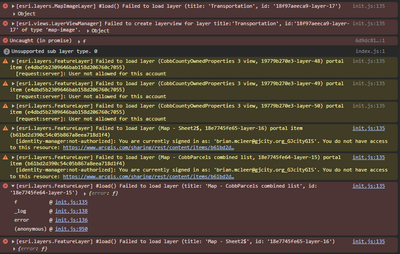

I get issues in the console log when looking at your URL, it seems like there may be sharing settings that need updated beyond the print widget.

Is this supposed to be a public application, as it is asking for credentials when I just perform a search?
Did you set your print service to be public?
ssun85739
This is a public application. What is the print service? Are you referring to the printer itself or something that needs to be set in experience builder?
ssun85739
I will double check and see if I missed any layers that have not been shared. If I want to check to see if there is any issues again, is there a way for me to access the console log?
JonM32
In Microsoft Edge, you would right click in the app, like over the legend, and go to Inspect.
The console tab is available at the top in the dialog that opens
Cheers,
Jon
If this response helps or is the solution to your post, please consider marking it as a solution
ssun85739
Thank you for the help. I used the console log and noticed that one of the links needed to be updated. We recently changed our domain from .org to .gov and it messed up the layers.
