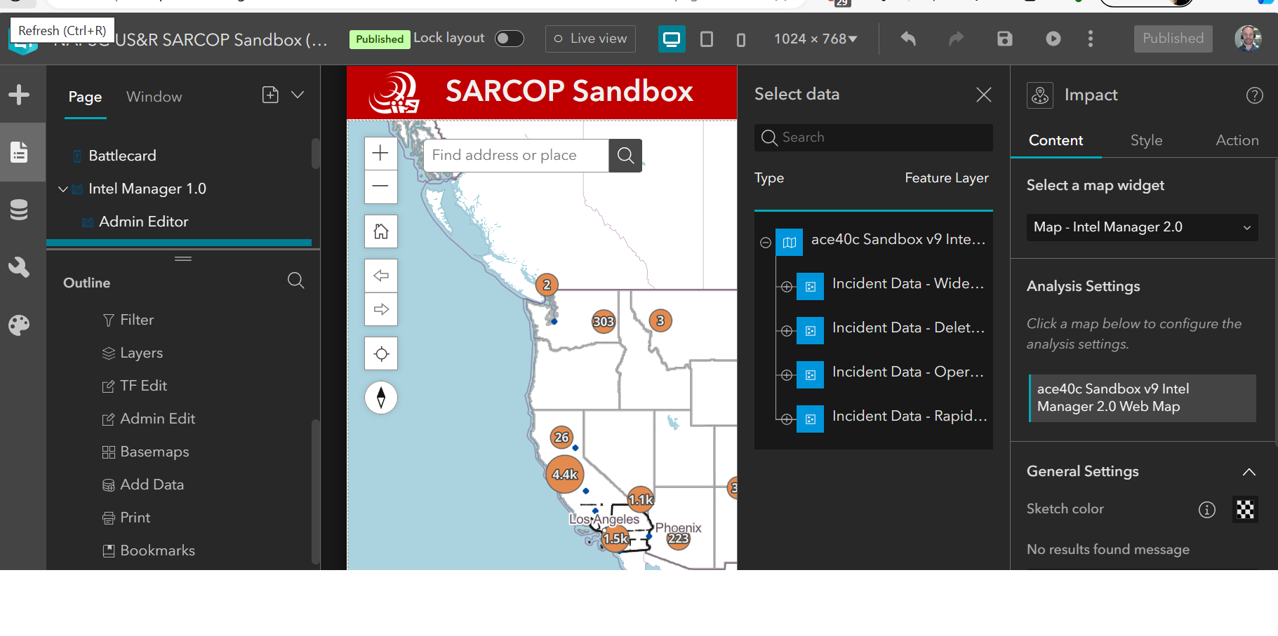

Technical Problem: Group Layer Items cannot be accessed by the NearMe Widget in Experience Builder (ArcGIS Online).

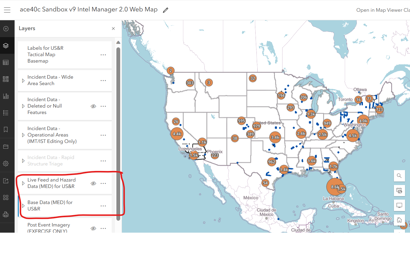

In this web map, the Incident Data group were made in the web map but not saved as items. The "MED" Groups for Live Feeds and Base Data highlighted below are Group Layer Items added to the web map.
Copy of Web Map with Group Layer Item retained: COPY OF ace40c Sandbox v9 Intel Manager 2.0 Web Map (arcgis.com)

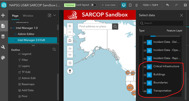

Experience Builder NearMe configuration, note the layer groups made in the web map (but not saved as items) load and are accessible, but the Group Layer Items highlighted above do not show up here.

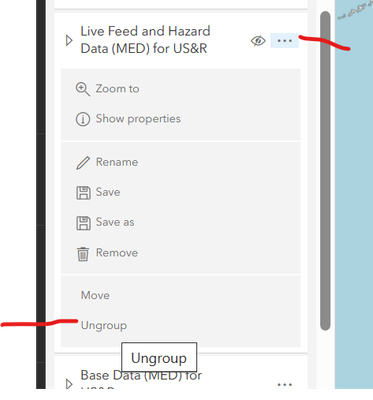

Workaround for now:
Ungroup the item in the web map
This allows the layers (or groups within) to be accessed by the widget.
This not ideal because now I broke the connection between the group item and this web map, but should buy us some time until Group Items are fully supported.
