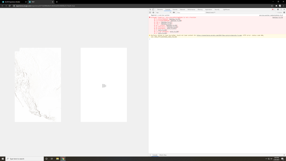

SandraCHayden
I get the same error. I am using Chrome Version 88.0.4324.190 (Official Build) (64-bit).
I made a blank app with a map on a single page, which worked. Then I duplicated the map. The error is:

PatriciaJames
A member of the public experienced the same issue with one of our Public applications. We found that the computer was unable to support WebGL2 so the Chrome browser automatically disabled it and did not allow it to be reenabled. The application worked on FireFox but was very slow.
