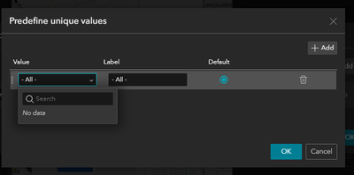

KrisKarki
Hi I am having this issue. One month ago when I created filter widget using same data, it works, but now it doesn't. I'm not sure what is going on now.
TonghuiMing
@K_Smyth4 @KrisKarki The 'No data' scenario varies from case to case - depending on the network or data-specific configurations, and so far we have come across several different causes. It might be more effective to provide data/app or contact support directly.
KrisKarki
When I use layer from ArcGIS Online FTP layer, it works. When I use same data published in AcrGIS server doesn't show data [it shows no data]. We use ArcGSI server 8.1 may be this is the reason.

TonghuiMing
Paco
Excellent @TonghuiMing .   thanks again for your help,  upping the Records 'Page size' number now shows all unique values. cheers!
