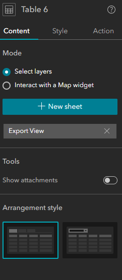

In the Table widget config, are you using Select layers or Interact with a map widget? Please provide screenshots of your config.

Select Layers. Screenshot included.
