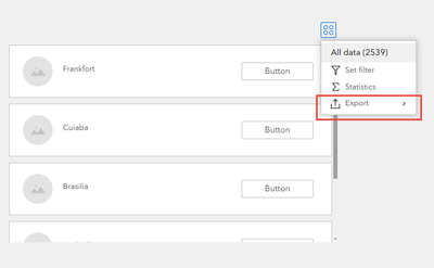

Widgets such as list, table, and feature info support the export option.

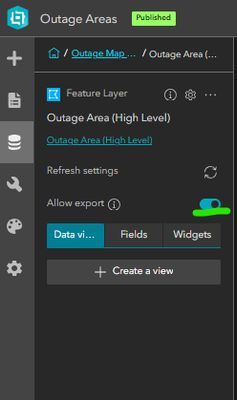

I see you have already toggled the allow export option in the data sources tab.

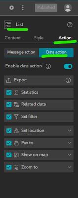

Next thing to check is if your widget is configured to export data.
You can do this by selecting the widget then going into Actions -> Data Action and enable data action.
Hope that fixes it for you.

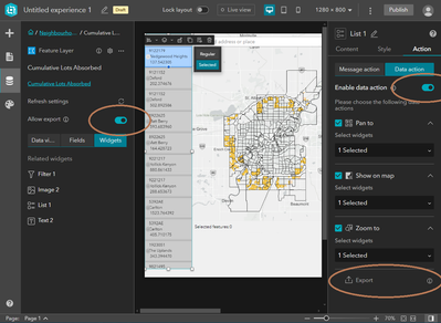

I activated both of the toggles that you've mentioned.
However, when I test out the dashboard with the Action button included, The export button is not available.  Thanks for your help!

Is the feature service you are trying to export from configured to allow exports? Controlled from the details page of the item itself, not from within Experience Builder. This might help: Problem: The Option to Export Data from Widgets is Unavailable in ArcGIS Experience Builde
