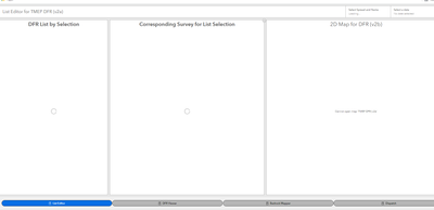

Hi,
I had a tabular theme going in experience builder where I am embedding multiple dashboards, however, as of this morning it is no longer working as expected.  This worked great last week - I saw there was a recent update that changed some things, but why would this be impacted?  It is coming from our ArcGIS Online, same place experience builder is located.  I tested the embed functionality in Story Maps & Hub - they were fine still.

My dashboards were all working fine yesterday, and still work on their own.  However this afternoon on my experience, my embedded dashboards and maps don't connect.  The dashboards work fine out-side the experience, but not as imbeds.
