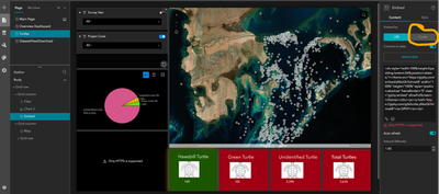

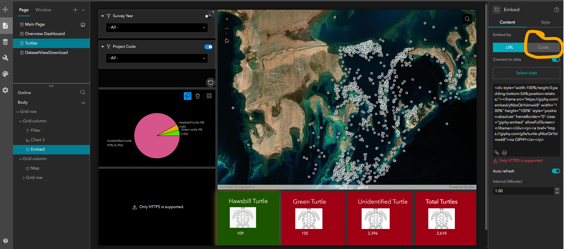

Hi
I'm using ESRI Education license and I was dsigning  an application and i was trying to use embed widget for uploading an SVG code but code tab is disabled , is there any limitation.
I was attached the screenshot
Looking forward to hear suggestions from experts
Thanks

This is the expected behavior. Embed by code only supports organizational accounts
https://doc.arcgis.com/en/experience-builder/latest/configure-widgets/embed-widget.htm#ESRI_SECTION1...
