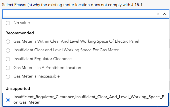

Error 1: “Value should be one of the listed values”
When I click on the drop down, it tells me:
If I blank out the selection, it clears the error:

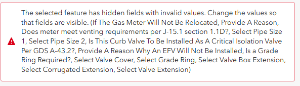

Error 2: “The selected feature has hidden fields with invalid values”
The funny thing about this one is that these fields are hidden because they are not relevant (based on previous responses). These fields SHOULD NOT show up on this feature at all, so it doesn’t make sense why we’re getting this error for the hidden fields.
