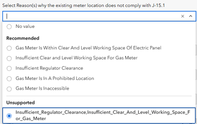

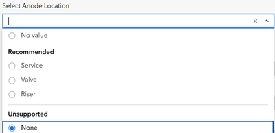

Error 1: “Value should be one of the listed values”
When I click on the drop down, it tells me:
If I blank out the selection, it clears the error:

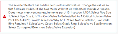

Error 2: “The selected feature has hidden fields with invalid values”
The funny thing about this one is that these fields are hidden because they are not relevant (based on previous responses). These fields SHOULD NOT show up on this feature at all, so it doesn’t make sense why we’re getting this error for the hidden fields.
Error 3: “Value should be one of the listed values”
This question is a multiple select in Survey123. I know there are limitations with the Edit widget and multiple-select questions right now, but we’ve never had this issue come up purely from previously entered data from Survey123. It’s like when the response is viewed in the layer now, it just cannot accept the previously entered data.

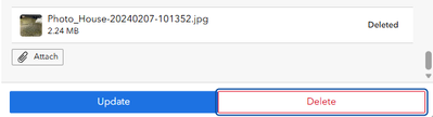

Error 5: Unable to delete photo attachments (when prior to the June update this worked just fine)
I suspect this is linked to the above errors. We’re unable to save changes to features (including deleting attachments) because we can’t clear the errors for hidden fields.

@MollyBurton is it possible to get a repro case for Error 2?  You can DM me.  If the map is publicly shared, I just need the link otherwise, you can invite my user "craig_sp" to a group with the data.

  • Error 5 - I also can't reproduce, I'm able to successfully delete Attachments. Could you test on a layer / map that doesn't have the hidden fields erorr?

My customers just told me that they have been experiencing errors 1 and 3 since the update. On error 3, even when there is no value at all, it is saying that "no value" is unsupported or it will show it as completely blank and say, "value should be one of the listed values". I was able to duplicate the issues. We have historic values that are no longer in the domain value list that need to remain as they are. Because it is essentially making these changes required, we are unable to continue updating data as needed from Experience Builder. Field Maps is not having these same issues.

@ToddJohnson We're targeting a fix for issues 1 and 3 mentioned above. From your screenshots, it appears that the fixes we're working on will address your issues but without a reproducible case, I can't say for sure.  If you're able to provide me access to your data, I'm happy to test our fixes against your maps/data.  You can DM if this is possible.
